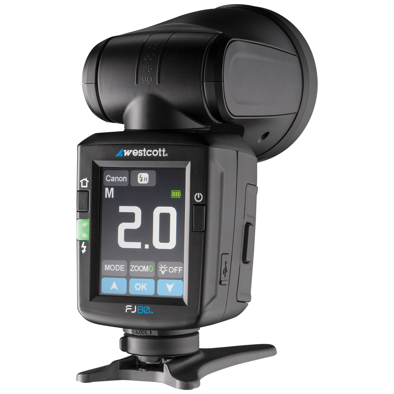

Ну, вот и Westcott подтянулись с запиленной под них JINBEI HD-2
FJ80 Universal Speedlight
Цена $329.90
Technical Specs:
Maximum Power 80 Ws
Energy Range 9 F-stop (.3Ws to 80Ws)
Flash Duration (t0.1) 1/250-1/3300s
Flash Duration (t0.5) 1/800-1/10000s
Recycle Time 0.05 - 1.2s
Continuous Capture 20 FPS (Camera Model Dependent)
Color Temperature Stability Normal/TTL/HSS: 5500±150K
Mounting System FJ80 Magnetic Mount (ф75)
Flash Increments 0.1-Stop and 1.0-Stop
Flash Modes Manual, TTL
IGBT Yes
Flash Exposure Compensation (FEC) ±3
Modeling Lamp LED 3W 5600K ±200K
Sync Functions HSS, Normal (Front & Rear Curtain)
Sync Speed Up to 1/8000s (High-Speed)
Wireless Radio Frequency 2.4GHz
Wireless Channels 31 (01-31)
Wireless Groups 16
Wireless Range 328'
Display LCD Touchscreen Color Display
Auto-Dump Yes
Cooling Passive
Voltage Stabilization Yes
Heat Protection Yes
Port Type USB-C for Firmware Updates (PC, Mac)
Auto-Power Off Yes
Audible Beep Yes
Auto Memory Recall YesFJ80 Speedlight
FJ80 Battery
Flashes Per Charge 400+ at Full Power
Battery Type DC Lithium Polymer
Capacity 11.1Wh, 1000mAh
Voltage 11.1V
Recharge Time ~2 hours
Battery Charge Input AC 100-240V, 50-60Hz, 0.5A
