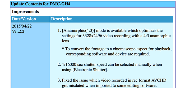

New GH4 firmware update will be released later this month (adds 1/16,000 fps). First review by TheCameraStoreTV!
Re[sonera]:
добавили выдержку 1/16000 не плохо
